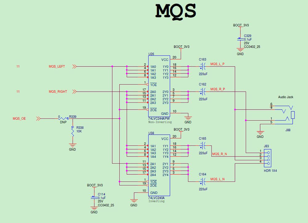

  We designed a new project using RT1064 MQS with external speaker amplifier to drive a speaker, but  the sound doesnot sound good, from below link, it seems the MQS need external filter circuit, do you have the referce hardware design?
What's the board you are using to drive the speaker for below demo?

This is the recommended MQS hardware:
You need to add the external circuit by yourself.

  I tried in-series a 220uF cap in between RT1064 and Speaker Amplifier, but the waveform(after 220uF cap) is PWM like instead of analog waveform, is it normal?
  Do I need addition RC circuit after 220uF cap?

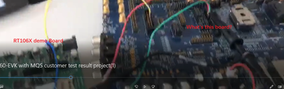

  From your video, the MQS is output from RT106X demo board, to another board(what's this board? do you have the schematic), then direct to speaker?
5,561件の閲覧回数
kerryzhou
Hi @zhirongyang ,
   The other board is our internal validation board, I just use that board's MQS driver circuit, the circuit I have share with you in the last reply. The schematic is from my testing validation board.
  You can use 74vc244, the input is from MQS pins, which don't need to add RC circuit.
   You also can find my 74 circuit is very simple, you even can find the chip and solder one, external circuit is very easy.

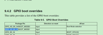

If your  GPIO_AD_b0_04 and GPIO_AD_B0_05 no output, comment GPIO_B0_00 and GPIO_B0_01, test it again. Please also note, GPIO_AD_B0_04 and GPIO_AD_B0_05 is the special pin, it is the BOOT_MODE pin.
When you do reset, please make sure you connect nothing, after the code is boot, then you can test the related pin, otherwise, it will influence the chip boot, thanks.
