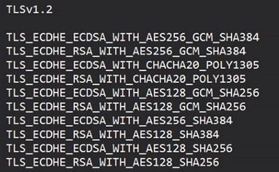

Hi Sir,
If our customer needs support TLS 1.2 or 1.3 based on RT1062(AES128 only).
Is it possiable?
Or, They needs design change RT1062 + SE050,
or change platform to RT116x
or RT1062 + FW AES256 (Merge it to Mbed)) etc..?

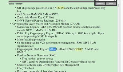

If customer want to support TLS1.2  (SHA384 & AES256), they needs upgrate to RT11xx series, right?
2,889 Views
kerryzhou
Hi @StephenYeh ,
   I am Kerry, Jeremy already leave NXP, thanks.
  RT1170 can support AES256, sha384, but RT106X can't support SHA384
