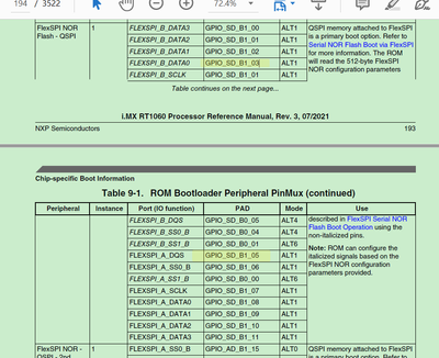

Hi Sir,
I try to use RT1062 EVK (Rev-A2) to config GPIO_SD_B1_05 and GPIO_SD_B1_03 to GPIO.
But, it will fail on hardfault.
I import the SDK sample code (evkmimxrt1060_iled_blinky), and modify the GPIO setting by GPIO config tool and generate the code.
Note: My FW is boot from SPI-ROM (0x60000000).
Does the GPIO_SD_B1_05 and GPIO_SD_B1_03 set to GPO(Alt5)?
1,274 Views
kerryzhou
Hi @StephenYeh ,
You are using the flash related pins.
To the EVK QSPI, it is not use B port, so GPIO_SD_B1_03 maybe OK.
But, you use the GPIO_SD_B1_05, which is the DQS pin, it will influence the flexSPI communication.

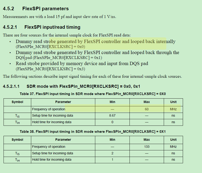

Please check the datasheet:
If you use the DQS pin, configure to the looped back interrnally, and the flexspi clock frequency limit to 60Mhz.
Wish it helps you!
