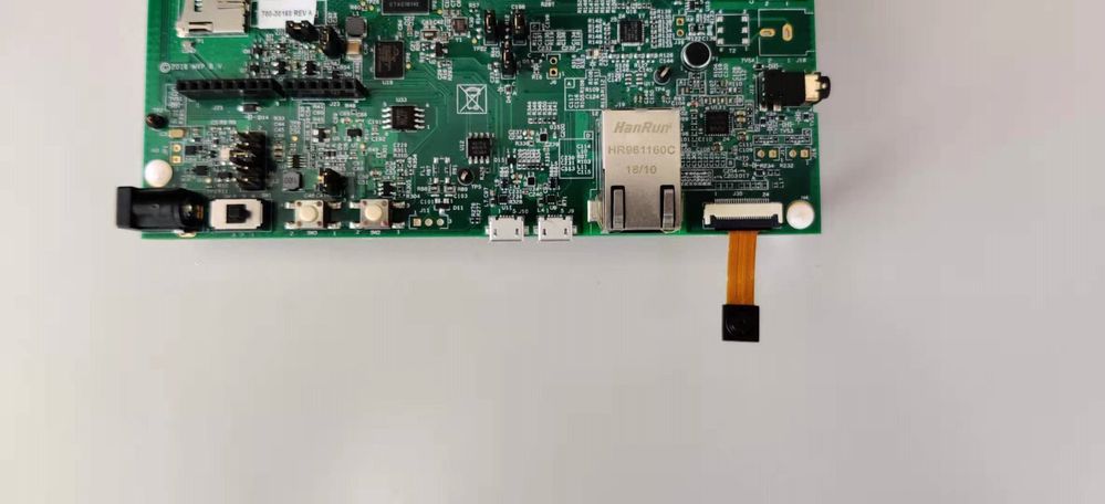

Dear collegues,
I would like an example of communication, for example I2C, of the RT1050 family processor with a CMOS image sensor, for example the BF3901CS (BYD Manufacturer) sensor.
Can someone help me?

Hi Rubens Junior,
Thanks for your reply.
Regarding the camera interface, please refer to page 15 in the attachment.
Fig 1 Camera interface

Hi Rubens Junior,
There're some CSI demos in the SDK library, it presents how to receive the camera data using CSI driver.
These code demos are suited for the OV7725 and MT9M114, please refer to them for details.

Hello jeremyzhou‌,
Thank you so much for your return. Please send us a connection diagram of the IMXRT1050-EVKB board with the camera?

Hi Rubens Junior,
