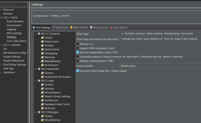

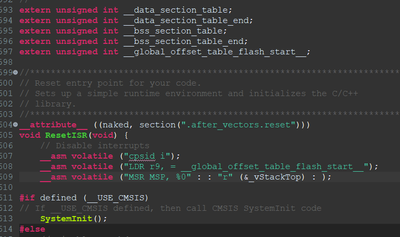

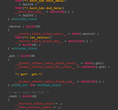

However, I can't get it to work. Here are the steps I took:
I started a project from scratch with only a flashing debug LED. Modified the linker:
Setting the compilation options:
Adding the correct reference in the r9 register:
I load the .bin file at address 0x60080000 I created a bootloader project with only a jump to address 0x6008238D, which is the address of the reset handler 0x6000238D + the offset.
During the jump, the code fails.
I must be missing an operation, can you help me?

Gaetan
One thing that seems strange to me is the contents of the .map in the .got section.
I don't know if it's normal for there to be so little.

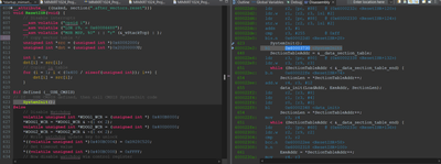

Gaetan
I think I'm close to the goal.
I've hard-coded all the values into the startup file.
When I disassemble the code, something seems strange: the function addresses are static despite the -pFIC option.
