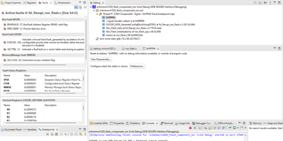

By default both of them have unchecked the following setting Link application to RAM
If I check this setting, as all the code is placed in RAM both examples run fine, but with the default configuration, that is having the program in Flash as I need for my project, both examples crash:
flash_component_nor:
Debugger starts but then a Fault occurs:
flexspi_nor_polling_transfer:
First execution the program is stucked at some point and it is not recovered, from now on if trying to launch the application again the debugger is not even starting:
To recover the device I need to connect it with 'NXP MCU Boot Utility' and perform a 'Connect to ROM' once.
Any help on how to be able to implement a flash read/write while program is stored in the flash is very appreciated.

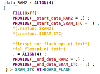

You can refer to the flexspi_polling_transfer example. There is a linkscripts folder in the project. When compile the project, MCUXpresso IDE will read the .ldt file in this folder to generate new link file.
Jing

Yes, I have seen the example and I understand the Linker generation, I see the resulting '*.ld' file contains these settings, for example:
My question was about if any other consideration should be also take into account.
