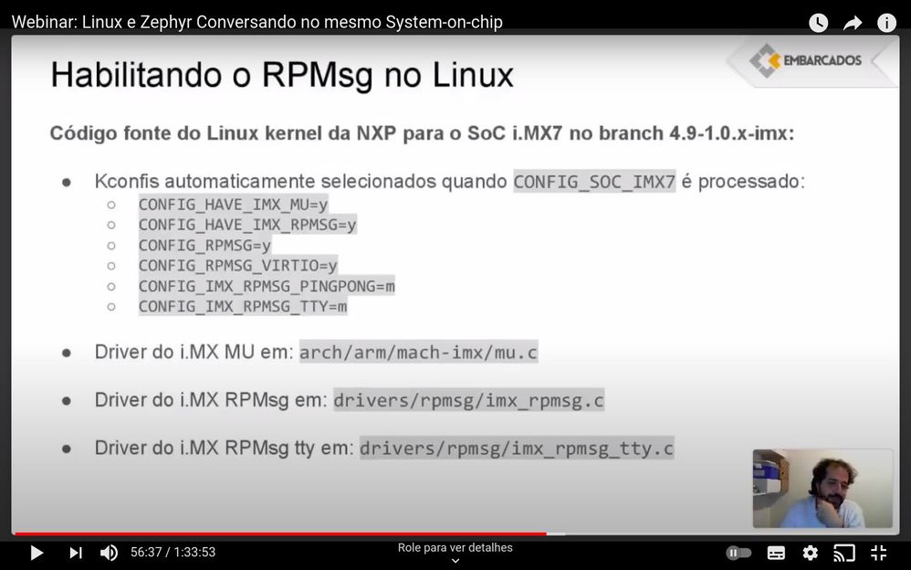

I have been interested in communicating between the a7 and the m4 of my imx7d-pico using RPmsg for a long time.
Today I found that this tutorial: https://www.youtube.com/watch?v=4zMyjaEgj2U&t=1182s
I don’t use mainline linux. I stay using kernel 5.6.xx with libgpiod 1.5
Using libgpiod I want to press a controlled button on a7 and flash an LED (which is waiting for this command) on m4
I was checking the issue link below and I have 2 questions below:
https://community.nxp.com/t5/i-MX-Processors/I-cant-get-the-linux-side-of-yocto-rpmsg-example-for-im...
  1. How can I adapt this project: https://hub.mender.io/t/technexion-pico-pi-imx7/136/61
    to the nxp forum project (link above) for me to get the following files: mu.c, imx_rpmsg.c, imx_rpmsg_tty.c and/or imx_rpmsg_tty.ko
  2. What is the best way to do RPmsg communication between a7 and m4 using Yocto on a7?

neuberfran
hi @igorpadykov
In this video: https://mail.google.com/mail/u/0/?tab=rm&ogbl#all/FMfcgzGkZsrTzPBfwTMTnDdMWlJRQlCW
at 23 minutes and 17 seconds, Diego Suero uses the following files:
../arch/arm/mach-imx/mu.c
../drivers/rpmsg/imx_rpmsg.c
../drivers/rpmsg/imx_rpmsg_tty.c
What are the equivalent files (on mainline linux, one of them seems to be: ../drivers/remoteproc/imx_rproc.c)
so that I can implement RPmsg on mainline linux correctly?
Or is the approach to mainline linux (RPmsg) in imx7d-pico different?
