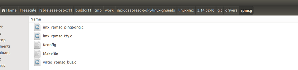

After that, you can check the RPMSG source code in below path:

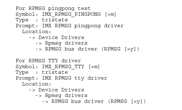

$ bitbake linux-imx -c menuconfig
Find the path Device Drivers -> Rpmsg drivers -> RPMSG bus driver -> select the tty driver, and then save it.

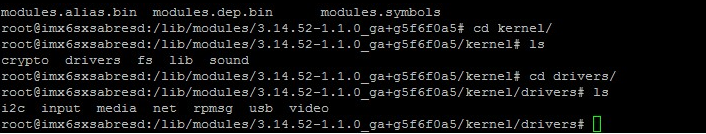

For A9 console, you can find the RPMSG driver in below:

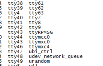

and then execute 'cd rpmsg" to enter into it,  insmod imx_rpmsg_tty.ko, then you will find the 'ttyRPMSG" in /dev/ directory, shown below:

  $ bitbake linux-imx -c menuconfig              //menuconfig
  $ bitbake linux-imx -c compile -f                 //compile
  $ bitbake linux-imx -c deploy                      //deploy

    I  used two of steps to build the core image, which are "DISTRO=fsl-imx-x11 MACHINE=imx6sxsabresd source fsl-setup-release.sh -b build-x11" and "bitbake fsl-image-gui", after that, I can find the RPMSG source code path as shown below:
   for the qt5 image, I think it should have included the same files in qt5 image, try to find the path in your machine.
