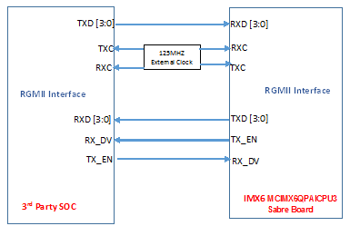

I am attaching one file can you please help me out in cross verifying the connections i have made for my board (i.e. MAC to MAC).
Another one query regarding TXC and RXC clock i.e. 125MHZ clock will be externally given or how it is?

9,096 Views
Pavel
Yes, External 125 MHz clock source is needed. Find the "RGMII without a PHY" in the following document:

9,095 Views
niteshsahay
Hi Pavel
Thanks for the reply.
One query on Clock:
1) Only single oscillator can be used to generate 125 MHz for TXC and RXC or two different oscillators are used to connect TXC and RXC.
2) Can we have one zero clock delay to generate two output which will be individually connected to TXC and RXC.
BR\Nitesh
9,096 Views
Yuri
   it is enough to provide common for both i.MX6 parts ENET_REF_CLK.
Yuri.
