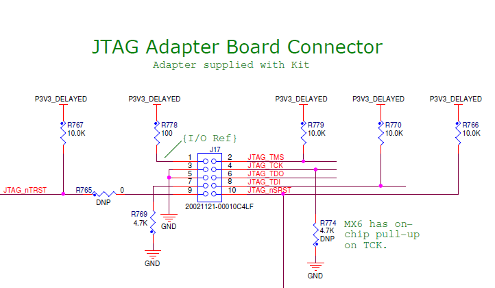

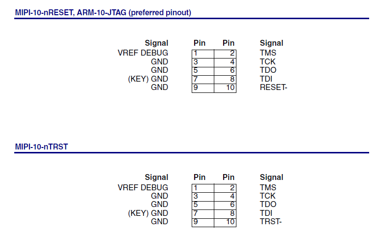

dharitrihazarik
Thanks for the response Artur. I have one more doubt.
I am confused with the jtag connector connections;
In lauterbach guide the connections are given as below:
But in Sabre (ref schematics), they have connected it as below:
Can you please clarify regarding the 9th Pin connection? Does it has to be connected to TRST or should it be grounded?
Dharitri
3,693 Views
art
If R765 is not populated (as marked on the schematic above), the connector of your JTAG probe can remain unchanged.
Artur
