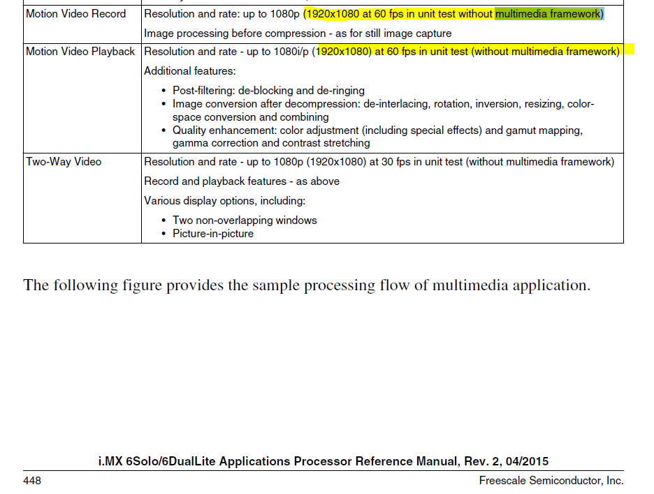

  I have the following questions regarding IMX6 capabilities:
  1. In the TRM, what is meant by “60 fps in unit test without multimedia framework”?
  2. What is that multimedia framework referred to? Specs I found were a few years old. Cannot see to find anything newer.

Hi Enrique
1.2. "without multimedia framework” means not using video player or other high level
application.
