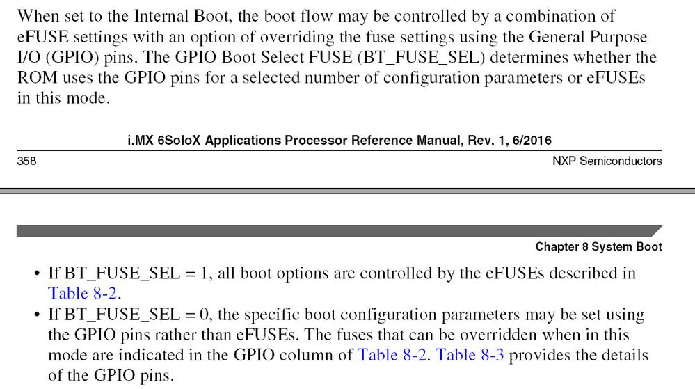

this behaviour is described in sect.8.2.3 Boot From Fuses mode (BOOT_MODE[1:0] = 00b)
i.MX6SX Reference Manual
http://cache.freescale.com/files/32bit/doc/ref_manual/IMX6SXRM.pdf
"If set to Boot From Fuses, the boot flow is controlled by the BT_FUSE_SEL eFUSE
value. If BT_FUSE_SEL = 0, indicating that the boot device (for example, flash, SD/
MMC) was not programmed yet, the boot flow jumps directly to the Serial Downloader."
igor

for case BT_FUSE_SEL = 1 all boot options are summarized in sect.8.2.3, 8.2.5 RM:
In Internal Boot mode (BOOT_MODE[1:0] = 0b10):
If BT_FUSE_SEL = 1, all boot options are controlled by the eFUSEs
In Boot From Fuses mode (BOOT_MODE[1:0] = 00b):
if BT_FUSE_SEL is blown (BT_FUSE_SEL = 1) ROM code performs an
internal boot according to eFUSE settings.
igor
