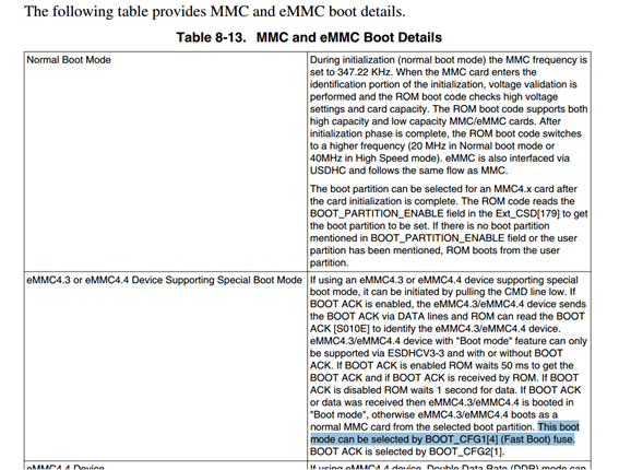

We found the following written in RM at ‘Table 8-13. MMC and eMMC Boot Details’.
“This mode can be selected by BOOT_CFG1[4](Fast Boot) fuse.”
Should user set BOOT_CFG1[4] into ON(1) not only for SD fast boot but also for eMMC fast boot?
And in the Table8-13, the following written is seen. (Under the blue line.)
“BOOT ACK is selected by BOOT_CFG2[1].”
The BOOT_CFG2[1] is described in Table5-5 as ‘Fast boot Acknowledge disable’.
We believe that BOOT_CFG2[1] written in Table8-13 is typo and the correct is BOOT_CFG1[2].
Correct?
yes, also for eMMC fast boot
>Correct?
yes

Regarding “BOOT_CFG1[4] description RM is correct, also I checked
i.MX6SL ROM sources, it uses BOOT_CFG1[4] during eMMC fast boot.
