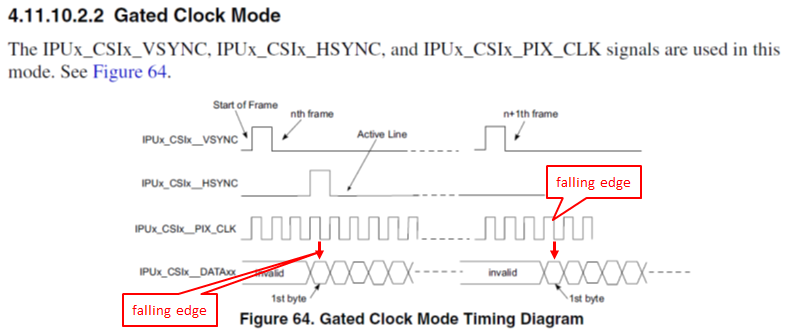

ko-hey
Senior Contributor II
Hi Igor
Let me confirm more.
According to the Figure 64, the IPUx_CSIx_DATA is latched at falling edge of IPUx_CSIx_PIX_CLK in Gated clock mode.
However, you answered that data is latched at the rising edge of pixel clock.
So the following figure is wrong. Am I correct ?
If yes, do you have any plan to revise it ?
Ko-hey

igorpadykov
Hi Ko-hey
As the polarity of pixel clock can be changed with
IPUx_CSI0_SENS_CONF[CSI0_SENS_PIX_CLK_POL]
so picture above can be consdired as correct too.
igor

ko-hey
That's right.
Thank you.
