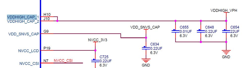

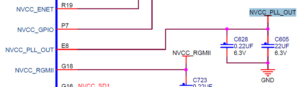

1. Which bulk capacitor is better to connect VDDHIGH_CAP and NVCC_PLL_OUT ?
Following recommendation is in design checklist.
Only one 10 μF bulk capacitor should be connected to each of these on-chip LDO regulator outputs: VDDHIGH_CAP/NVCC_PLL_OUT/VDDUSB_CAP.Decoupling capacitors such as 0.1 μF or 0.22 μF should also be used.
But VDDHIGH_CAP/NVCC_PLL_OUT is connected to 22μF bulk capacitor in SPF-27417_C4.pdf.
Which is better, 10μF or 22μF ?
Also please tell the reason why SDP use 22μF.

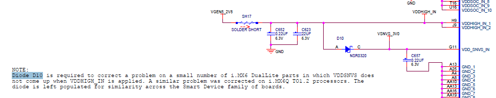

2. Can we remove diode D10 ?
Following note is in schematic.
NOTE:
Diode D10 is required to correct a problem on a small number of i.MX6 DualLite parts in which VDDSNVS does
not come up when VDDHIGH_IN is applied. A similar problem was corrected on i.MX6Q TO1.2 processors. The
diode is left populated for similarity across the Smart Device family of boards.
In my understanding, diode D10 need only for when using silicon revision 1.2.
So we can remove the diode D10 when we use rev 1.3. Is my understanding correct ?

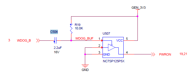

3. What is the funciton of C504 capacitor ?
In P21 of SPF-27417_C4.pdf, WDOG_B is connected to 2.2μF capacitor.
What the purpose of it ?

1.
  Please follow recent Design Checklist recommendations.
The board was designed earlier.
2.
  From the Design checklist : "If VDD_SNVS_IN is directly supplied by a coin cell, a
schottky diode is required between VDD_HIGH_IN and VDD_SNVS_IN. The cathode
is connected to VDD_SNVS_IN. Alternately, VDD_HIGH_IN and VDD_SNVS_IN can be
tied together if the real-time clock function is not needed during system power-down."
3.
The scheme may be considered as CR differentiator, which forms PWRON pulse .

2.
My custom board don't have coin cell.
In that case, I don't need the schottky diode.

2.
yes, there is no the diode, but it is recommended to tie VDD_HIGH_IN and VDD_SNVS_IN together,
