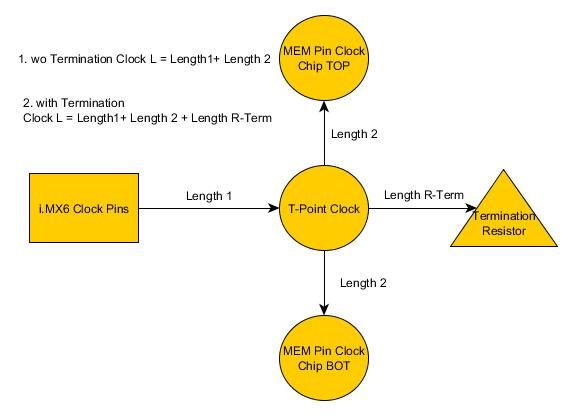

Hello MX users,
i have a question about the i.MX6 Routing, actually i have matched all Lines but i need a Informations about the Clock Length Calulation.
Whath of the following 2 calculation sheems is the Right:
1. With Termination Resistor Length
i get A Complete Length of 2120 mils per Clock Line ( CLK X + /-)
2. Without Termination Resistor Length
i get a Complete Length of 2450 mils per Clock Line ( CLK X + /-)
What is the right value? I need it for the Rule Adress = max Clock -200 mils...

Hi Thomas
right calculation is without Termination Resistor Length R.
igor
