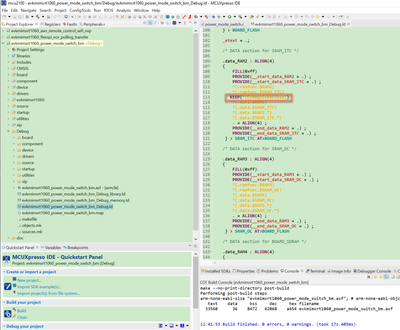

Note: I compared the .map file when I have this linker script section (below, right) to when I don't (below, left). The only difference I found was this line that was added:
Perhaps you can explain what this difference means?

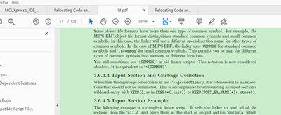

  In fact, you need to check the ld KEEP meaning at first:
You can also search it from website:
https://stackoverflow.com/questions/9827157/what-does-keep-mean-in-a-linker-script
Wish it helps you!
Kerry

3. Could you please explain what the new line added to the .map file does (shown above)?
Answer: You can see, your right side, map contains codeQuickAccess, it means, it insert the memory range to the ITCM, and that memory is named as codeQuickAccess.
In fact, both method can indicate the code to the ITCM, just define codeQuickAccess range it is more easy to control by the SDK, it is the SDK code style.
