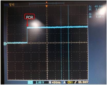

4. How to check the operation
- Check EIM CS1(R627) operation using oscilloscope
5. Test result
- EIM CS1 pin does not move
- When writing data (*(unsigned char *)(0x8400000) = 0x0A;) ,
  uboot init no longer proceeds and kernel is not loaded.
