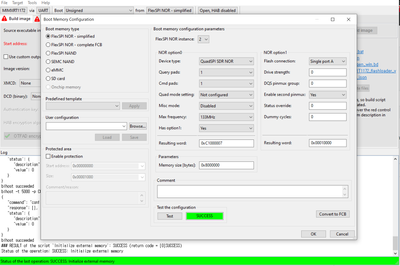

I have a problem with Program, Flashloader for IMXRT1176 on Flexspi2 Instance A.
I have designed my custom board with QSPI flash on the following pins

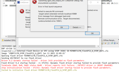

I also tried to change the Driver as below
But error still happen as shown in the image.

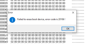

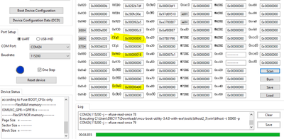

After that, I followed some guides from the community to try to burn from Fuse or change but It showed another problem, could not erase or write when using the Boot Utility tool.

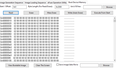

- Scan and burn into the IC
- read from the Boot Device Memory tab
But an error happens when clicking the "Erase" or "Write" button.

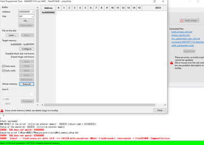

Hello, I reviewed your case, could you download the next tool MCUXpresso Secure Provisioning Tool | NXP Semiconductors this will be needed for the next test. Could you tell me what kind of memory you have? I mean the ID number.
For the first step will try to check the communication to the memory.
1. Select board.
2. Select communication, put the board in serial download.
3. Select memory.
4. Test the memory.

Thanks for your response.
I succeeded in testing with a setting as below.
But still can not erase, flash the firmware via Flash Program Tool

Hello, sorry for the late response, I was researching more information about this case, and I found the next.
MCUBLHOSTUG.pdf (nxp.com)
4.2.5 flash-erase-all [memoryID]
If any flash regions are protected, the command fails with an error. If any flash regions are reserved by the bootloader, they are ignored (not erased). If the VerifyWrites property is enabled, the flash-erase-all command performs a flash verify erase all operation, or multiple flash verify erase options if decomposed due to reserved regions.
Please review this thread maybe could help you.
Solved: blhost fails to erase flash region - NXP Community

Error when clicking the Erase and Write button was "Failed to erase boot device, error code is 20106"
