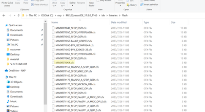

Hi!
I am trying to use the MCU-Link with our i.MXRT1024 MCU in MCUXpresso IDE but when trying to flash using the GUI Flash Tool I see that the Default Flash Driver is not set.
I looked into i.MXRT1024's page (as I saw in this ticket) but I cannot find it into the Software section like I found it into MPC5777M's page (this is the one for the ticket) as "MPC5700 C55FG Flash Standard Software Driver".
Did I missed something?
Thanks!

  Use this path:
C:\nxp\MCUXpressoIDE_11.8.0_1165\ide\binaries\Flash
Wish it helps you!
Kerry

Hi @rvigneault ,
 If your MCU-LINK is using the CMSIS DAP as the debugger, then you just need to use the RT1064.CFX file in the MCUXPresso IDE is OK, just like this:
You can download the RT1024 SDK code from this linker:
mcuxpresso.nxp.com
Wish it helps you!
Kerry

Hi @kerryzhou ,
Thanks for your answer, I think that it brings me in the right path.
When I select "Browse" in the "Default LinkServer Flash Driver" config, it gives me a file browser.
Is the right MIMXRT1024.cfx file to use the one from C:\nxp\MCUXpressoIDE_11.8.0_1165\ide\binaries\Flash or from C:\nxp\MCUXpressoIDE_11.8.0_1165\ide\plugins\com.nxp.mcuxpresso.tools.bin.win32_11.8.0.202307121429\binaries\Flash ?
Thanks!

It works!!
Thanks a log @kerryzhou and I hope that you had great holidays!!
