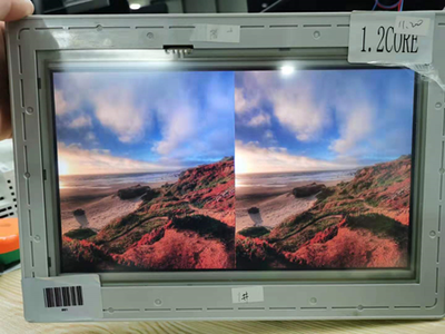

Chip: MIMX8MM6DVTLZAA
BSP:  L5.4.70-2.3.0, uboot version is 2020.04
Dispplay: mipi to RGB by LT9211, referent driver has been modified and initialized.
            Screen resolution: 1024*600referent configuration has been checked OK.
Question:
In uboot stage, the screen displays as below.
From uboot to kernel, kernel will read the same frame buffer transmitted from uboot,  the display is OK.
What is the reason for it, and how to fix ?
Thanks.

Hi Jimmy
for that issue one can recheck mipi clocks as described on :
https://community.nxp.com/t5/i-MX-Processors-Knowledge-Base/Setting-i-MX8M-Mini-and-Nano-MIPI-DPHY-C...
igor

jimmyli
Contributor V
Hi Igor,
      We will check again.

mesahin
Hello jimmyli,
Can you share  reference driver LT9211 ?
