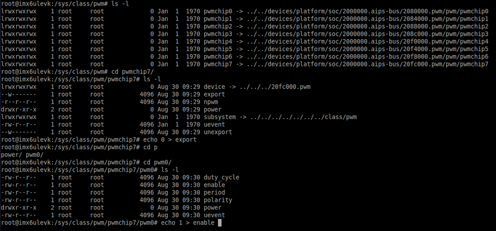

pastrana
Hi BiyongSUN,
I have a similar problem as almarto, however I am not able to solve it. I made the changes that you explained. Please, could you tell me if it is something missing?
Moreover, when I enable the PWM in the sysfs, the operative system blocks.
1) File: "imx6ul.dtsi"
                        pwm7: pwm@020f8000 {
                                compatible = "fsl,imx6ul-pwm", "fsl,imx27-pwm";
                                reg = <0x020f8000 0x4000>;
                                interrupts = <GIC_SPI 116 IRQ_TYPE_LEVEL_HIGH>;
                                clocks = <&clks IMX6UL_CLK_DUMMY>,
                                         <&clks IMX6UL_CLK_DUMMY>;
                                clock-names = "ipg", "per";
                                #pwm-cells = <2>;
2) File: "imx6ul-14x14-ddr3-u15.dts"
&pwm7 {
        pinctrl-names = "default";
        pinctrl-0 = <&pinctrl_pwm7>;
        status = "okay";
                pinctrl_pwm7: pwm7grp {
                        fsl,pins = <
                                MX6UL_PAD_CSI_VSYNC__PWM7_OUT           0x110b0
3) Finally, when I tried:
And the it blocks.
Do you have any idea what could it happen?
Thanks a lot.
Javier.
