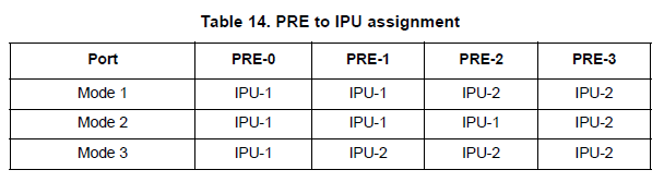

I would like to connect 2 PREs to one IPU (as shown in the diagram below). I am using fb0 and fb1 (overlay). As I understand, the both framebuffers can be connected to separate PRE. Could you please guide me how to add a proper entry in devicetree?

There is one PRG per IPU and each PRG can handshake between 1 to 3 PRE and one IPU. Please see the image below:
PRE-0 is dedicated to IPU-1, PRE-3 is dedicated to IPU-2, PRE-1 and PRE-2 can be configured to be used together with either IPU-1 or IPU-2.

Thanks for your answer, but is it possible to configure the devicetree to use 2 PRE for one display? Or should I modify the driver?
