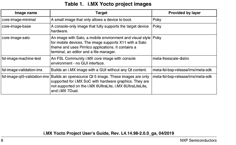

nagendrasarma
i am trying to add apache to imx8 + 'fsl-image-qt5-validation-imx' and getting following error
ERROR: Required build target 'fsl-image-qt5-validation-imx' has no buildable providers.
Missing or unbuildable dependency chain was: ['fsl-image-qt5-validation-imx', 'apache2']
is imx8mq + fqt5 image support web server ?
if yes which web server is better and how to add to yocto ?

Bio_TICFSL
the fsl.image-qt5-validation-imx is only supported by MX6UL, MX6ULL and MX7D.

nagendrasarma
Hello  Bio,
please find attached image for reference, according to nxp-yocto-imx documentation rev: L4.14.98_2.0.0_ga 4/2019
fsl-image-qt5-validation-imx is NOT supported on imx6ul, imx6uLL imx7dual
so, please help me in making yocto project with php.apache2, and lhttpd on imx8mq evk ?
