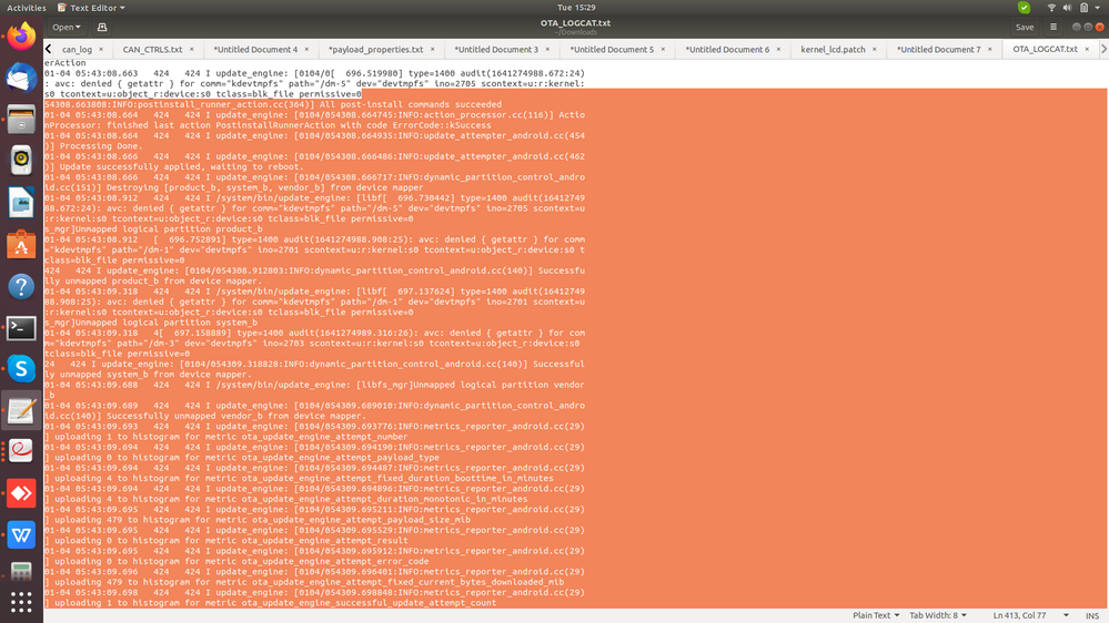

I have tried OTA full package update with Android TM User's Guide(android 10.0.0_2.6.0) as reference. Tried to update with both update_engine_client and adb side load method. Once the update got successfull with message "Update successfully applied, waiting to reboot", I tried to reboot the board. After that the boards stops at kernel.
Note: In both the methods update is failing some times. In success case it is not booting upto android and stops in kernel.
Kindly help on this issue. Thank you in advance.

Error log after update is done and rebooted:

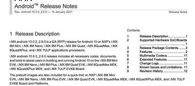

Hi @afridi20
I don't find any aosp for 8dxl from Android release note.Currently,we haven't release official AOSP for i.MX8DXL.
Best Regards
Zhiming
6,791 次查看
afridi20
@Zhiming_Liu But I am trying OTA in Imx8 dual x processor which is of  Imx8x family.
Android version - 10.0.0_2.6.0
6,780 次查看
Zhiming_Liu
As release note shown, i.MX8dual X is not in support device list.

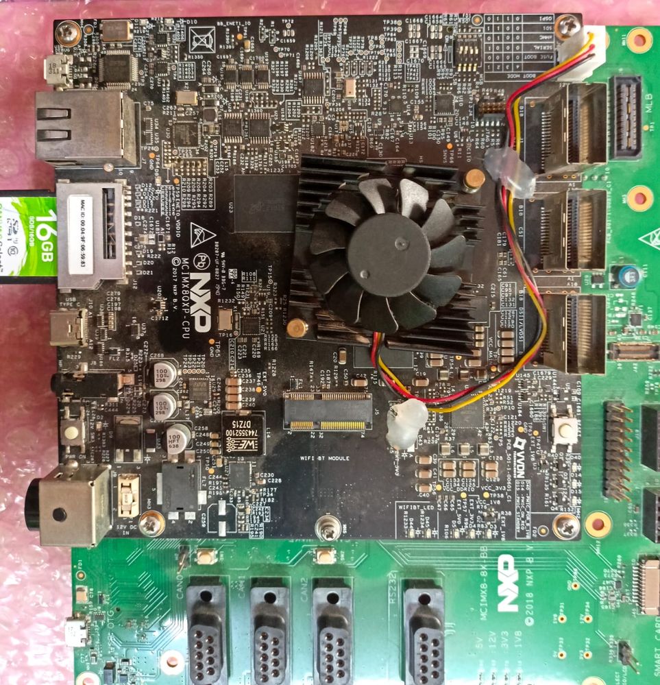

afridi20
@Zhiming_Liu
Today I have tried OTA update for i.MX8 QuadXPlus board with update_engine_client and adb sideload .
In both cases I am able to get "Update successfully applied, waiting to reboot". Once I have restarted the device manually, I got the below errors.
Kindly help on this issue and please let me know if changes has to be done.
Error log after "Update successfully applied, waiting to reboot" :

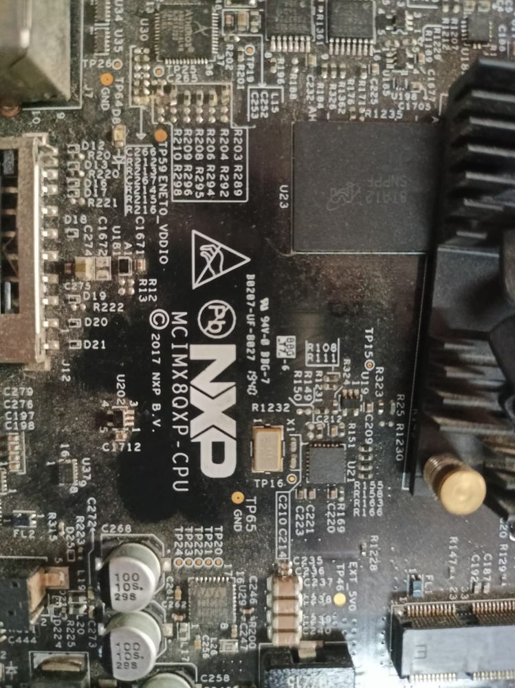

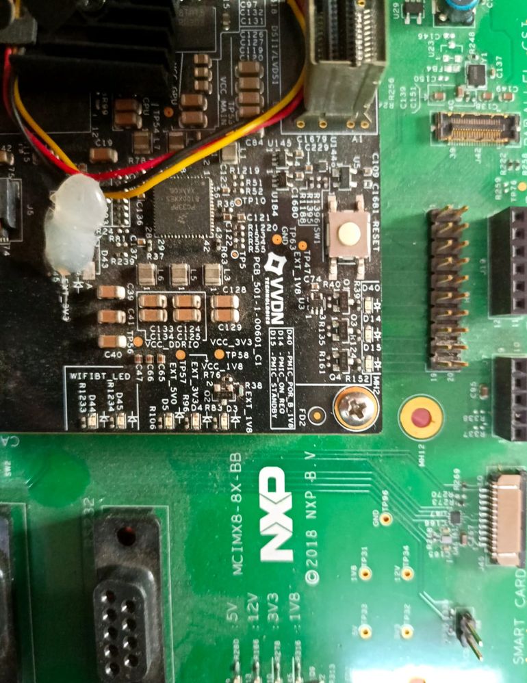

afridi20
@Zhiming_Liu
I am using i.MX8QXP Rev B0 for testing OTA. Also I have use custom i.MX8DX Rev C0 for testing the same.
6,746 次查看
