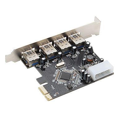

EgleTeam
Contributor V
Hi Robert,
which chipset uses your USB card?
Try a card using VLI800 or similiar (quite cheap cards). We have tested the bandwidth up to 110MB/s on a single USB 3.0 port ("dd").
Manuel.
24,568 次查看
robertferanec
Hi Manuel,
our PCIE USB card uses D720200F1 chip. Please, do you know the exact name of your USB card?
Thank you,
- Robert
24,568 次查看
EgleTeam
Contributor V
Hi robert,
Sorry I threw the box out and the board doesn't say anything: seems to be generic. Please google "USB 3.0 PCIE" and you will find the card quickly:
Is a good card to evaluate but a bad option, my guess, for final products: is thinner than it should be so the card is no stable inside the PCIe socket.
Manuel.
