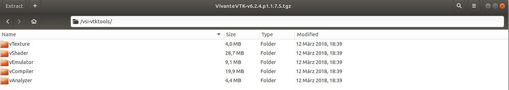

I am using offline opencl compiler VivanteVTK-v6.2.4.p4.1.7.8 on i.MX 8M. When I execute the main.cpp example code on target. I get the following error
"Creating program with binary...
[ 1] gcSHADER_LoadHeader: shader binary file's version of 1.0.1:26 is not compatible with current version 0.0.1:20
Please recompile source.
[ 2] gcoOS_DebugBreak(1001)
Building program...
!!! Error # -44 at line 245 , in file main.cpp !!!"
My GPU device is Vivante OpenCL Device GC7000L.6214.0000  and I have used viv_gpu_imx8mscal.config as GPU configuration file.
Please let me know, how can I fix this issue.
Than you very much!

Hello again,
I would like to add some more information. My opencl version is "opencl  1.2 v6.2.4.p1.150331". opencl version and vivante version should be the same. However, I do not find the matching vivante for my opencl (https://www.nxp.com/products/processors-and-microcontrollers/arm-based-processors-and-mcus/i.mx-appl...).
There is a vivante with similar version VivanteVTK-v6.2.4p1.1.7.5 but there is no opencl compiler inside that version.
I would greatly appreciate your help.

The vivante 6.2.4p1.1.7.5 has the openCL compiler on it, but you are using a diffferent config file for it, viv_gpu_imx8mscal. is for i.Mx8Mscale and you need the i.MX8M.
1,716 Views
golchin2010p
 Thank you very much for your feedback. I will use the correct config file but inside the  vivante 6.2.4p1.1.7.5 , I do not see any vclcompiler. Vclcompiler.png
