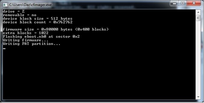

I downloaded the image of the WEC7 from adeneo link and tried to boot the QSB START-R board by following the steps given in “FREESCALE_iMX53_QSB_WEC7_user_guide_V131.pdf”.
I have tried to boot the Start-R board by image "........\iMX53QSB_WEC7_BIN_V131\image\START-R\VGAPanel" by using uSD card by using following commands
    cfimager -f D:\UPPSALA\WIN_BSP\iMX53QSB_WEC7_BIN_V131\image\START-R\VGAPanel\eboot.nb0 -d H -imx53
cfimager -f D:\UPPSALA\WIN_BSP\iMX53QSB_WEC7_BIN_V131\image\START-R\VGAPanel\nk.nb0 -d H -imx53 “
After this command if i insert uSD card in START-R board by connecting the power cable and VGA cable, nothing is visible on VGA.

We are also having the exact same issue - everything seems to be starting up OK via the terminal output, but no VGA video output. We are using Freescale MCIMX53-START-R Rev D0. We do not have any touchscreen LCD card. We are using the HDMI daughter board, but we are looking at the VGA output.
Many thanks,
