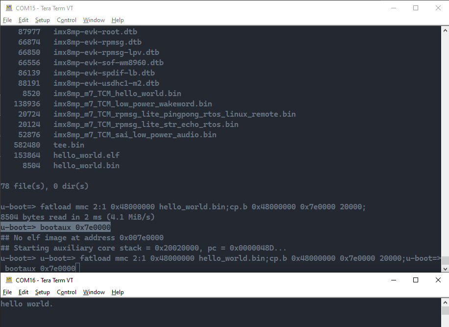

I am working on a imx8mp and am to bring up the Cortex M7 core.
I downloaded the SDK and followed the steps in the session 5.2 (of MCUXSDKIMX8MPGSUG) to generate my binary images.
I was able to flash the image on my custom board and I got this message from the u-boot terminal
PicoCoreMX8MP # bootaux 0x7e0000
## Starting auxiliary core stack = 0x20020000, pc = 0x0000048D...
However, there was no (hello world) display at my serial terminal.  I have checked the serial connection and the setup and all looks fine.
I also checked the hello world example code but I did not find anything in it.
What can I do or what am I missing to make the example code work.

Sorry for the late reply.
I have been able to solve the problem.  Among the steps I took was to reconfigure the pins for the uart.  Thanks

u-boot=> fastboot 0
PS C:\> uuu -v -b fat_write .\hello_world.bin mmc 2:1 hello_world.bin
u-boot=> fatload mmc 2:1 0x48000000 hello_world.bin;cp.b 0x48000000 0x7e0000 20000;
u-boot=> bootaux 0x7e0000

I have also tested the steps you gave above but the result is still the same.   No output at the putty terminal and the message that the coretx M7 is started is same (as below)

I don't have experience with a custom board but I'd try the following.
1. Listen to all available UARTs in terminal.
2. Try Hello World in FreeRTOS from F&S. You can see that there is a customization for UART selection.
3. Delete EVK-SDK and instead download Processor-SDK. And there you should focus on the differences between PicoCore and EVK's SOM to adjust pin_mux.c
The last step is necessary if you are interested in using directly NXP SDK.
