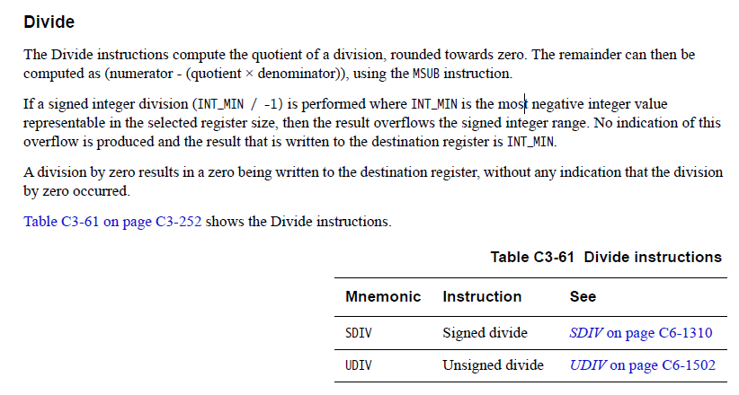

kimease
Arm® Architecture Reference Manual
Armv8, for A-profile architecture
Copyright © 2013-2021 Arm Limited or its affiliates. All rights reserved.
ARM DDI 0487G.b (ID072021)
No indication of this overflow is produced
A division by zero results in a zero being written to the destination register, without any indication that the division by zero occurred.
(that is why you find a = 0)

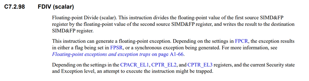

Please search fdiv to find information. floating divide has too many informati1, can not paste everything here.

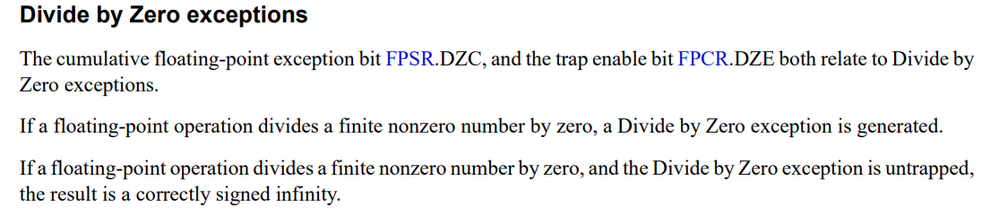

fffengzia
I am so glad that you got my point :-).
The problem of integer division by zero could get its answer now.
From the Architecture Reference Manual:
And from A1.5.7:

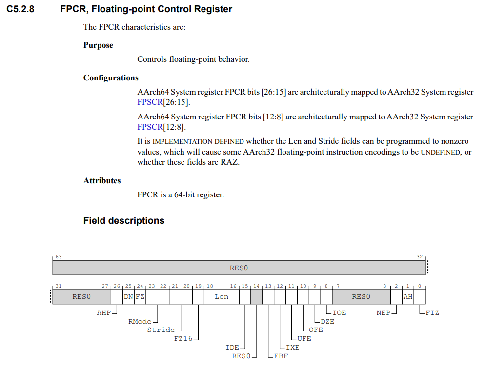

dze.pngdze.png About the FPCR:
However, it seems that this register is not forced to be used in every armv8 core, at least for a53:
ARM® Cortex®-A53 MPCore Processor
Advanced SIMD and Floating-point
Copyright © 2013-2016 ARM. All rights reserved.
ARM DDI 0502G (ID041316)
But not all a53 cores don't raise exception if floating-point division by zero. I have ever used another board from other manufacturer, which raise an exception if floating-point division happens. And I need to know if the a53 on imx8mmevk does able or not able to act like it.
I have referred to documents about imx8mmevk and could not found some useful.
