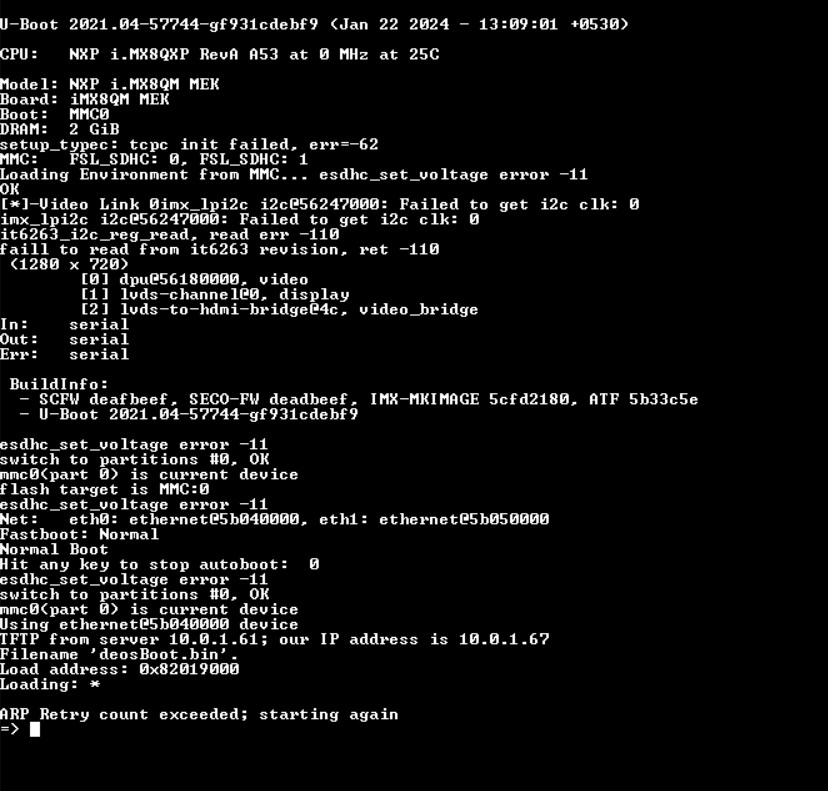

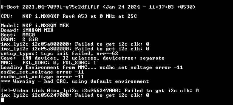

i'm using imx8 board on virtual environment on QEMU , my u-boot is working fine with 2021 version but 2023 version of u-boot not working
it stops like below
ErrorError
but it is working with 2021 version
Followed below link for setup

We don't support qemu case, from the sceenshot, you may need remove some drivers using i2c
