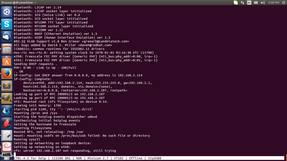

I am using linux 2.6.35 kernel version on MCIMX28EVK.
uboot version: 2009
MX28 U-Boot > printenv
bootargs=console=ttyAM0,115200n8
bootdelay=3
baudrate=115200
ipaddr=192.168.1.103
netmask=255.255.255.0
bootfile="uImage"
loadaddr=0x42000000
bootargs_nfs=setenv bootargs ${bootargs} root=/dev/nfs ip=dhcp nfsroot=${serverip}:${nfsroot},v3,tcp fec_mac=${ethaddr}
bootcmd_net=run bootargs_nfs; dhcp; bootm
bootargs_mmc=setenv bootargs ${bootargs} root=/dev/mmcblk0p3 rw rootwait ip=dhcp fec_mac=${ethaddr}
bootcmd_mmc=run bootargs_mmc; mmc read 0 ${loadaddr} 100 3000; bootm
ethact=FEC0
serverip=192.168.2.107
nfsroot=/home/dtsuser/ltib/ltib/rootfs/boot/
bootcmd=run bootcmd_net
stdin=serial
stdout=serial
stderr=serial
ver=U-Boot 2009.08 (Sep 26 2014 - 16:03:20)
I am facing "no init found" issue.Please help me to solve this.

pt
Senior Contributor I
Hi gonfer
Thanks.But now I am facing another issue.
Bluetooth: HIDP (Human Interface Emulation) ver 1.2
802.1Q VLAN Support v1.8 Ben Greear <[email protected]>
All bugs added by David S. Miller <[email protected]>
lib80211: common routines for IEEE802.11 drivers
mxs-rtc mxs-rtc.0: setting system clock to 1970-01-01 02:24:50 UTC (8690)
eth0: Freescale FEC PHY driver [Generic PHY] (mii_bus:phy_addr=0:00, irq=-1)
eth1: Freescale FEC PHY driver [Generic PHY] (mii_bus:phy_addr=0:01, irq=-1)
Sending DHCP requests .
PHY: 0:00 - Link is Up - 100/Full
.., OK
IP-Config: Got DHCP answer from 0.0.0.0, my address is 192.168.2.114
IP-Config: Complete:
     device=eth0, addr=192.168.2.114, mask=255.255.255.0, gw=192.168.2.1,
     host=192.168.2.114, domain=, nis-domain=(none),
     bootserver=0.0.0.0, rootserver=192.168.2.107, rootpath=
Looking up port of RPC 100003/3 on 192.168.2.107
Looking up port of RPC 100005/3 on 192.168.2.107
VFS: Mounted root (nfs filesystem) on device 0:14.
Freeing init memory: 176K
starting pid 1168, tty '': '/etc/rc.d/rcS'
Mounting /proc and /sys
Starting the hotplug events dispatcher udevd
Synthesizing initial hotplug events
Setting the hostname to freescale
Mounting filesystems
Booted NFS, not relocating: /tmp /var
mount: mounting usbfs on /proc/bus/usb failed: No such file or directory
Running sysctl
Setting up networking on loopback device:
Setting up networking on eth0:
nfs: server 192.168.2.107 not responding, still trying
Pt
7,210 Views
eliedebrauwer
Hello Pt,
Well, since you get the message 'Setting up networking on eth0' right before you loose track of your NFS connection it's likely that you reconfiguring your ethernet caused the NFS server to become unreachable. You could try making sure the ethernet configuration does not happen by editing your network settings on your nfs rootfs.
hth
7,210 Views
gonfer
Contributor V
I agree with Elie.
You could also try to disable "Start Networking" under Ltib. I don't remember exactly where you can find this option but you will find it easily.
Gonzalo.
7,210 Views
pt
Hi eliedebrauwer, gonfer
I have disabled that option. Now it starts working.
logged in.
Thanks to all.
Pt
