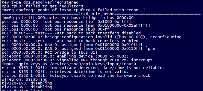

sunyd
the error message just below,but don't know how to resolve it ,tnank you very mach

igorpadykov
Hi synid
"imx6q-cpufreq.. error" may be related to board design: please check
that it has pmic, as i.MX6Q Sabre SD reference board, refer to sect.2.5.3 CPU
Frequency Scaling (CPUFREQ), sect.2.5.2 PMIC PF Regulator attached Linux
Manual. Try to use nxp linux from source.codeaurora repository
linux-imx - i.MX Linux kernel
May be recommended to recheck board with Sabre schematic on
Schematics (1)
Design files, including hardware schematics, Gerbers, and OrCAD files.
SABRE Platform for Smart Devices | NXP

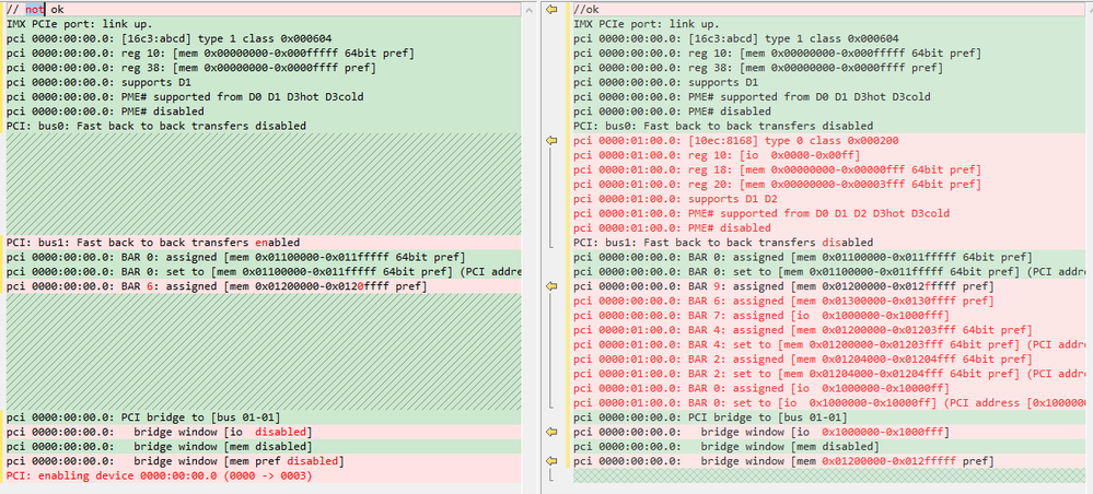

sunyd
left is not ok, right is ok  ,about pci, the problem may be not realted to imx6q-cpufreq?
3,199 Views
igorpadykov
"not ok" does not show errors, it also shows "link up" .
You can try to experiment attaching other pcie cards or
changing pcie card from good to bad and compare.
