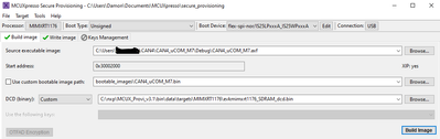

When using the MCUXpresso Secure Provisioning Tool, in the write tab, select the build output file (.axf) for the "Source Executable Image". The "Start address" will be automatically populated. Next, change "DCD (binary)" to "Custom" and navigate to your target's SDRAM_dcd.bin file, included in the Provisioning Tool's directory. For me, the GUI looks like this:
Now you can click on "Build Image", and it will work. Then go to the "Write image" tab, select the build image that you want to use (_nopadding.bin file), click "Start FlashLoader" and then "Write Image".
