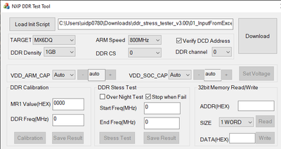

Can I run this program in multiple instances on a single PC to run multiple boards ?
I have different boards and would like to run them but on a single PC.
It is possible ?
How ?
Thank you for you support!

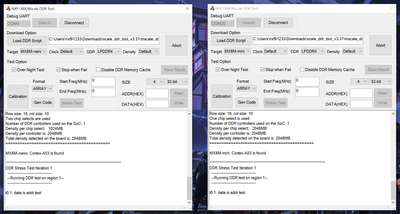

6,756 Views
JorgeCas
I was able to run both tests at the same time with the tool for i.MX8M.
But, it the case of i.MX6/7 tool, when is connected more than one board, it occurs an error.
Best regards.
