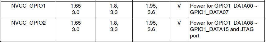

the internal connection as shown on the image attached confuses me abit.
Is it possible to supply different voltage levels (in this case 3V3 and 1V8) to NVCC_GPIO1 and NVCC_GPIO2?

Hello Lars,
Yes. different voltage can be supplied.
See datasheet, please!
