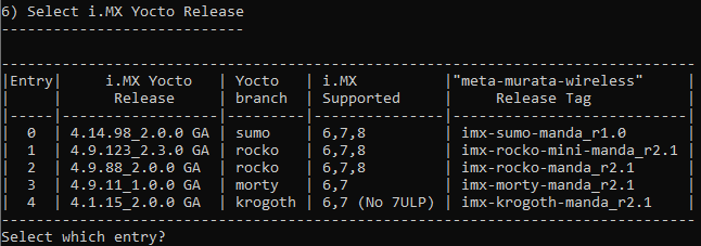

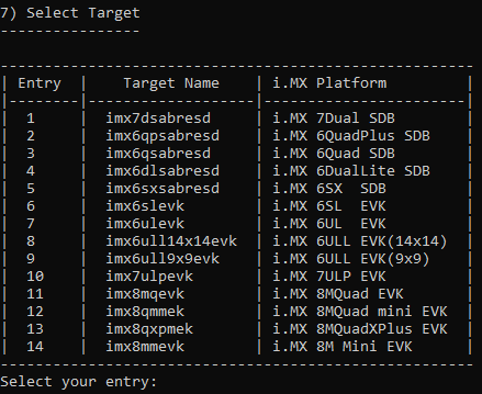

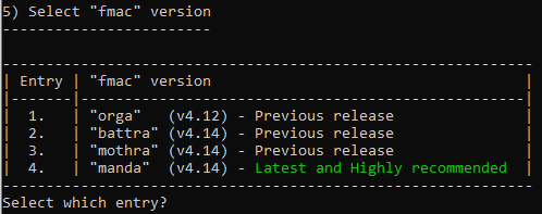

Which NXP Linux releases have support for Murata modules and where can I get the resources?
Labels (3)
2,280 Views
bill_chen1
Hi Romit
Murata supports NXP's Linux 4.14.98, 4.9.123, 4.9.88, 4.9.11, and 4.1.15 BSP. Murata offers a script file for building images for some of NXP's evaluation boards. With this build script, by selecting fmac version, Linux Kernel, target board, and target, the script will build an image for your target. The following snapshots show the main options for your image.
For more detail, please refer to Murata's Quickstart Guide.
https://wireless.murata.com/datasheet?/RFM/data/murata_quick_start_guide_linux.pdf
