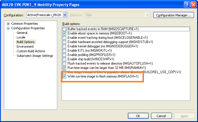

IMO if below parameter set then only IF IMGFLASH case will be applicable so in your suggested code in config .bib both conditions IF IMGFLASH and IF IMGFLASH ! are considered. Can you please review it what you mentioned?
6,524 Views

We are using IF IMGFLASH ! so below patch is not applicable right?
IF IMGFLASH
   IF IMGEBOOT
       ROMSIZE=03FC0000
       ROMSTART=90240000
   ENDIF
   IF IMGEBOOT !
       ROMSIZE=04000000
       ROMSTART=90200000
   ENDIF
   ROMWIDTH=32
ENDIF
My changes is exactly same as you mentioned but still could not load the image. Any other changes is required to make it for 256MB?
