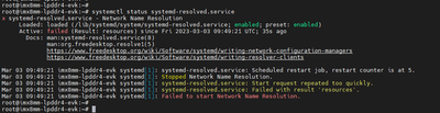

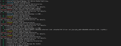

Then I burned core-image-minimal-imx8mm-lpddr4-evk-20240408092645.rootfs.wic and imx-boot-imx8mm-lpddr4-evk-sd.bin-flash_evk(uboot),But when I started, I encountered the following problem:
After I log in, enter the command:systemctl status system-resolved.service

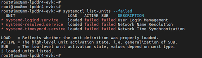

I have checked all failed services:

Maybe could be the modification that are you doing or the image.
The minimal image is a small image that only allows a device to boot, try to compile the "imx-image-core" that image has more features and should solve the Network failure.
