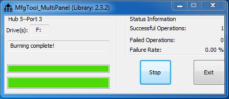

If I don't click stop button, MfgTool will repeat the burning process. Is that normal?
Why can't it stop automatically after xml commands are all executed?

When you use the mfgtool do download the images to your board, after success download, it will stop automatically and you can see download successful done. Here you need to check the setting of mfgtool first.

After download complete, the MfgTool window displayed this.
Yes, this means download successsfully, but if I don't click "Stop" button, and Exit, it will repeat to download the images after about 3 minutes.
Do you know where to set the MfgTool configurations to stop the repeat download?

Which board and BSP are you using? When download complete, I will click the stop button and exit.
Is your board designed yourself?

My board is customized based on imx6sl, and BSP is customized based on Yocto. But I think this has nothing to do with my board and BSP. You can try not click the stop button, and wait for about 4 minutes. Check if it will going to happen on your board.
