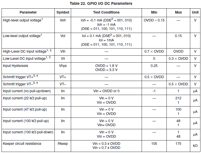

Hi Eli,
You could refer to section 4.6.2 “General Purpose I/O (GPIO) DC Parameters” of the datasheet:
Hope this will be useful for you.
Best regards!
/Carlos
2,496 Views
gusarambula
Adding to Carlos comment, there is not an injection current specified as acceptable. The datasheet states that no I/O pin should be externally driven why the I/O supply is OFF.
“All I/O pins should not be externally driven while the I/O power supply for the pin (NVCC_xxx) is OFF. This can cause internal latch-up and malfunctions due to reverse current flows.”
