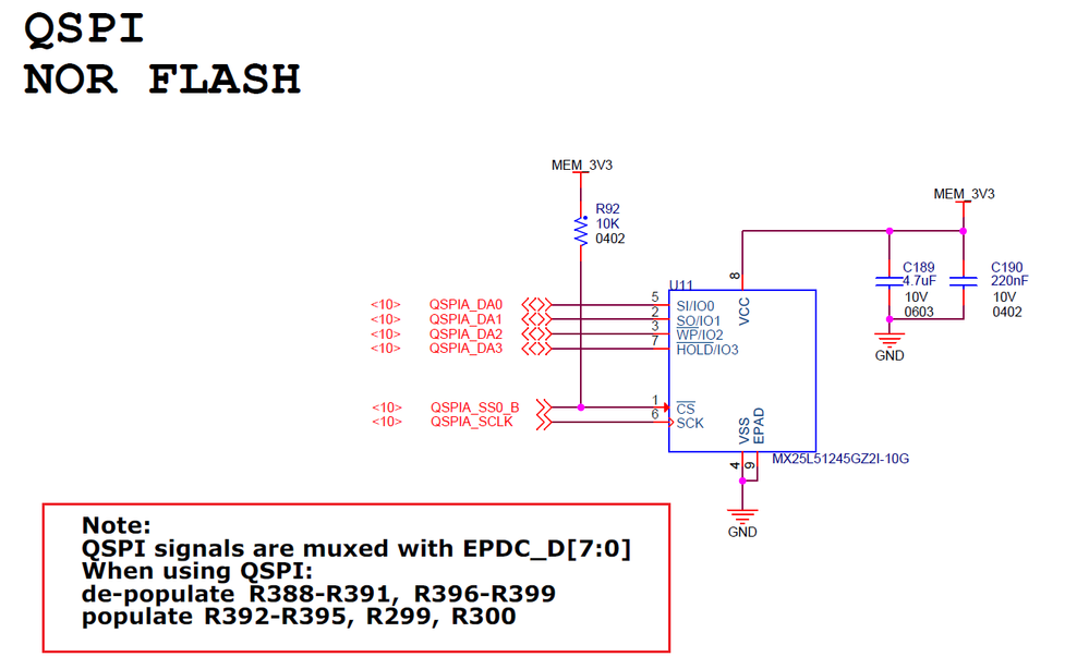

I want to boot our i.MX7 SABRE board from the onboard QSPI flash. I managed to activate the flash by reworking resistors as described in the QSPI NOR Flash section of the schematics. When booting via Serial Downloader, I can load and write bootloader binary image into QSPI flash.
However, the board does not boot from the QSPI device. I have removed the supplied SD card containing original u-boot and set BOOT_MODE switch SW3 to [10] (internal boot) and boot config switch SW2 to [10000000] as shown in schematics and printing on the board. It is only possible to load u-boot via serial download mode.

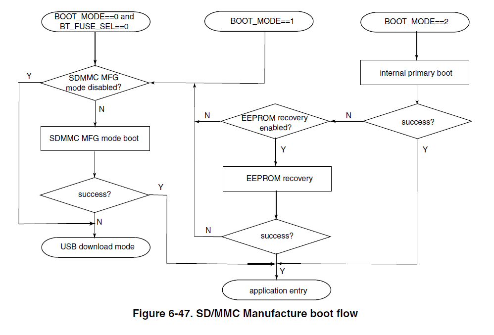

Looking further into this I found the description of the SD/MMC Manufacture Mode:
At least, I understand now why serial downloader is overridden when BOOT_MODE is set to 01b - the SDMMC MFG mode is not disabled on our board. Will try to find out why internal boot (BOOT_MODE = 10b) from QSPI fails now.
Your settings are correct.
>>See page 9 of schematic with PDF format
Some resistors should also be adjusted on MX7Sabre Board!
Have a nice day!
Weidong
3,116 Views
thomasschaefer
Hi Weidong,
thank you for your comments. As I said above, we already did the resistor adjustments (OK, we could not locate R398 on the PCB, but QSPIA_SS1_B is not used so I think this has no effect). Otherwise, we would not be able to read and write the QSPI flash.
There must be another problem with boot configuration settings. We have a second i.MX7 SABRE board here with no resistor modifications. I understand that fuses are burnt to boot from SD card, but when SW3 is switched to [01]  (serial download mode) the board still boots from SD card plugged in. It is not possible to boot via serial download mode then. Serial download mode will only work when SD card is removed from the slot.
I believe this is a mistake because it is not possible to boot the board in case that a broken bootloader is stored in the boot device that cannot be remove, e.g. a QSPI flash.
Can you explain what happens here?
