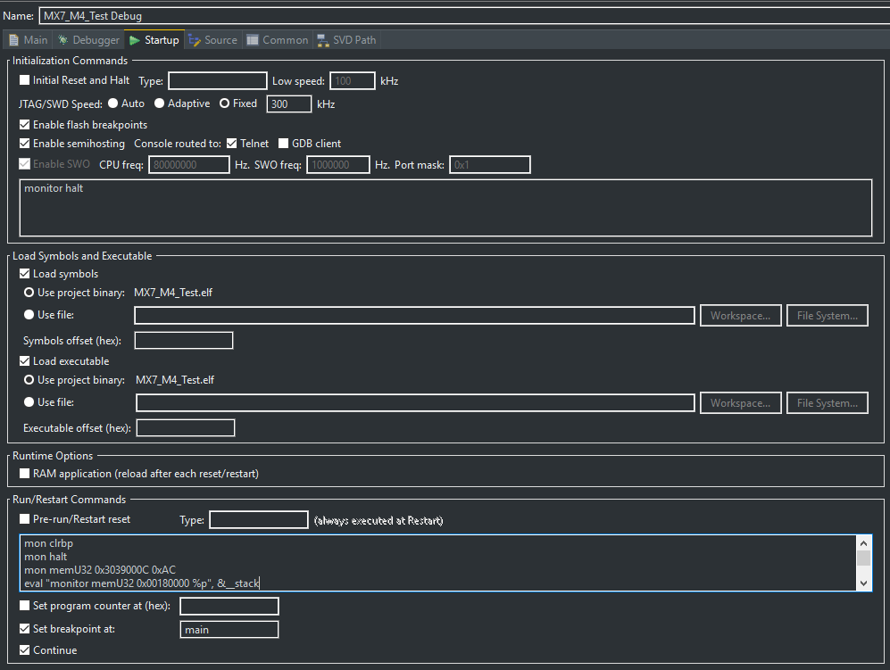

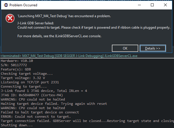

However, on trying to connect to the M4 through Eclipse (or standalone JLinkGDBServerCL.exe) I run into the following problem (even if the Segger MX7 M4 connect script is used):
This did not change if I use the script provided in your thread at first.
Adding the options to the debug configurations startup tab and disabling Pre-run/Restart reset I get the following error instead:
Error in services launch sequence
Starting J-Link GDB Server timed out.
Any idea what might be the cause for this? Starting Eclipse in Admin mode did not have any effect (I thought maybe Eclipse is not allowed to start the GDB Server)
Here are my startup settings:
14,749 Views

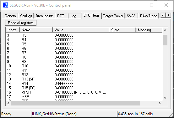

However, I do not see anything happen. As in:
The project is built, uploaded, and the status bar adjusts to "Launching <debug session name>:(100%)".
Eclipse switches to debug view. But all buttons like Resume, Suspend, Step over/into/etc are greyed out, except for "Terminate". No breakpoints are reached. So I assume PC/SP are set up incorrectly.
When looking at the SEGGER JLink control panel that pops up as a tray icon, I can see R13 and R15 (Stack pointer, Program counter) are 0.
I can set registers and correctly read their value back, so I assume this is not a readout error.
This is probably a misconfiguration in Eclipse?
After uploading the binary, the PC/SP should be set by Eclipse through the jlink i assume.
How can I find out what values these registers should have?
I am using a freeRTOS example project for this. I read they are all meant to be built for tightly coupled memory. Not sure if this refers to the usage of the provided batch/shell files for building a project. I have not set up any linker file from what I remember.
14,748 Views

Received monitor command: regs
R0 = 00000000, R1 = 00000000, R2 = 00000000, R3 = 00000000
R4 = 00000000, R5 = 00000000, R6 = 00000000, R7 = 00000000
R8 = 00000000, R9 = 00000000, R10= 00000000, R11= 00000000
R12= 00000000, R13= 00000000, MSP= 00000000, PSP= 00000000
R14(LR) = FFFFFFFF, R15(PC) = 00000000
XPSR 01000000, APSR 00000000, EPSR 01000000, IPSR 00000000
CFBP 00000000, CONTROL 00, FAULTMASK 00, BASEPRI 00, PRIMASK 00
Reading all registers
Setting breakpoint @ address 0x202141A6, Size = 2, BPHandle = 0x0001
Starting target CPU...
Debugger requested to halt target...
WARNING: CPU could not be halted
I assume the debugger requesting a target halt happened on hitting the breakpoint that was set before?
But halting the target didnt work, so .. hm.

So the commands as you inserted into Eclipse
eval "monitor memU32 0x00180000 %p", &__stack
eval "monitor memU32 0x00180004 %p", &Reset_Handler + 1
So those set the values SP and PC in the M4 reset control register (if i got the name right), through J-Link. They get loaded to SP,PC respectively, on M4 reset.
(Also note, you can't just hit Eclipse re-load / restart button with the configuration, you have to kill debug session and start it again each time you want to restart).
Set the break point in the reset handler. The temporary bpoint should work  - tbreak .
If you do not get there, there is a setup problem . You should hit it on the debug session start . If you do and can single step then it should all work .. (does for me).
If you suspecting Eclipse setup, I say do JLinkExe  / JLinkGDBServer + gdb from command line first.

demoniacmilk

This is interesting cause it did not appear before. It happens in both cases, Pre-Run/Restart reset ticked or not ticked.
I had changed the startup settings as in removing the custom commands in Run/Restart Commands and ticking Pre-run/Restart reset. Using these options, the debug session starts and Eclipse displays a running thread.
However, I cannot hold the CPU so I cannot read any registers.
I guess its all about finding a way to properly halt/resume CPU functionality and doing the initial setup. I can connect to the M4 using your updated connect script.

Running the JLinkGDBServer from the windows command line with command
JLinkGDBServerCL.exe -if jtag -speed 300 -scriptfile Devices\NXP\iMX7D\NXP_iMX7D_Connect_CortexM4_DRy_Mod.JLinkScript -device MCIMX7D7_M4
gives the following result (text in bold may be an issue?):
SEGGER J-Link GDB Server V6.30b Command Line Version
JLinkARM.dll V6.30b (DLL compiled Feb 2 2018 18:36:54)
Command line: -if jtag -speed 300 -scriptfile Devices\NXP\iMX7D\NXP_iMX7D_Connect_CortexM4_DRy_Mod.JLinkScript -device MCIMX7D7_M4
-----GDB Server start settings-----
GDBInit file: none
GDB Server Listening port: 2331
SWO raw output listening port: 2332
Terminal I/O port: 2333
Accept remote connection: localhost only
Generate logfile: off
Verify download: off
Init regs on start: off
Silent mode: off
Single run mode: off
Target connection timeout: 0 ms
------J-Link related settings------
J-Link Host interface: USB
J-Link script: Devices\NXP\iMX7D\NXP_iMX7D_Connect_CortexM4_DRy_Mod.JLinkScript
J-Link settings file: none
------Target related settings------
Target device: MCIMX7D7_M4
Target interface: JTAG
Target interface speed: 300kHz
Target endian: little
Connecting to J-Link...
J-Link is connected.
Firmware: J-Link V10 compiled Feb 2 2018 18:12:40
Hardware: V10.10
S/N: 50117772
Feature(s): GDB
Checking target voltage...
Target voltage: 1.81 V
Listening on TCP/IP port 2331
Connecting to target...
J-Link found 1 JTAG device, Total IRLen = 4
JTAG ID: 0x5BA00477 (Cortex-M4)
Halting target device failed. Trying again with reset
WARNING: T-bit of XPSR is 0 but should be 1. Changed to 1.
Connected to target
Waiting for GDB connection...
ill go ahead and start arm-none-eabi-gdb with the elf file to see what happens.

dry
Senior Contributor I
Hey,
Connected to target
Thats all good, ignore second warning. It attempts the reset which succeeds.
I get same traces too when uploading code.
