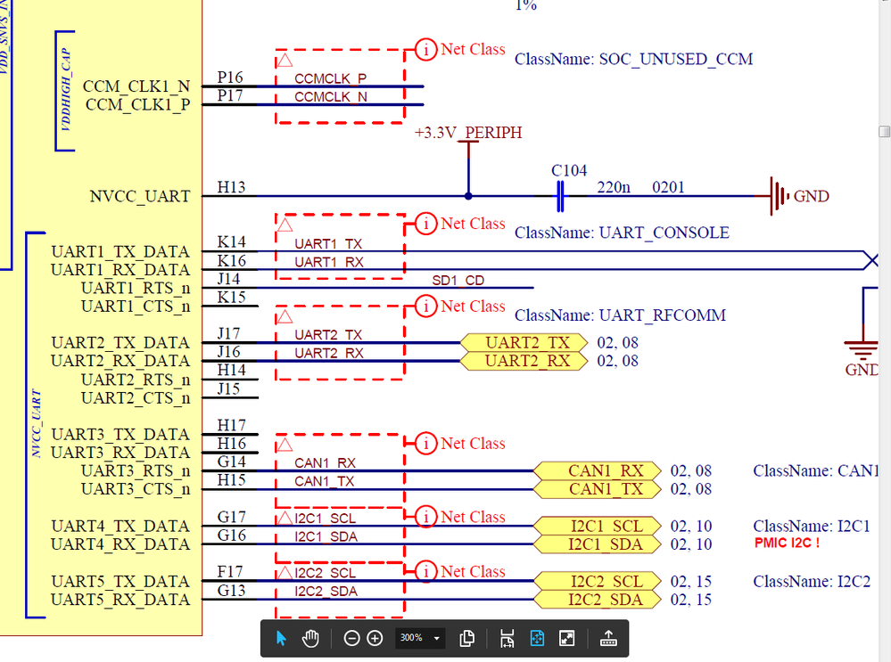

Dear all
UART2 from our custom MX6UL board is attached to a RN4871 Bluetooth Module
UART2 TX works fine but RX is not working
How can i configure uart2 rx properly?

 Please read the dtb (as is, in binary) from the board and send me.
Yuri.

Hello, nachodiz !
  from Your dtb configuration for UART2 :
serial@021e8000 {
compatible = "fsl,imx6ul-uart", "fsl,imx6q-uart", "fsl,imx21-uart";
reg = <0x21e8000 0x4000>;
interrupts = <0x0 0x1b 0x4>;
clocks = <0x1 0xbf 0x1 0xc0>;
clock-names = "ipg", "per";
dmas = <0x7 0x1b 0x4 0x0 0x7 0x1c 0x4 0x0>;
dma-names = "rx", "tx";
status = "okay";
pinctrl-names = "default";
pinctrl-0 = <0x37>;
fsl,uart-has-rtscts;
  First - RTS/CTS is not used on Your scheme, therefore  line "fsl,uart-has-rtscts;"
should be removed. Further - DMA cannot be used without RTS/CTS, so lines "dmas"
and "dma-names"  should be removed too. You may try enclosed dtb file.
  Note - high speeds cannot be used without DMA.
Yuri.

  Please check (and modify if needed) under Linux :
1) IOMUXC_SW_MUX_CTL_PAD_UART2_RX_DATA register (0x20E_0098) :
     if  bit field mux_mode = 0.
2) IOMUXC_UART2_RX_DATA_SELECT_INPUT ( 0x20E_062C) :
  if bit field DAISY = 01.
You may use memtool utility, located in /unit_tests directory of NXP BSP.
