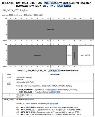

I don't understand how to configure MUX_MODE (imx8q)
Is this done in the device tree or elsewhere, if yes, then I don't understand how.

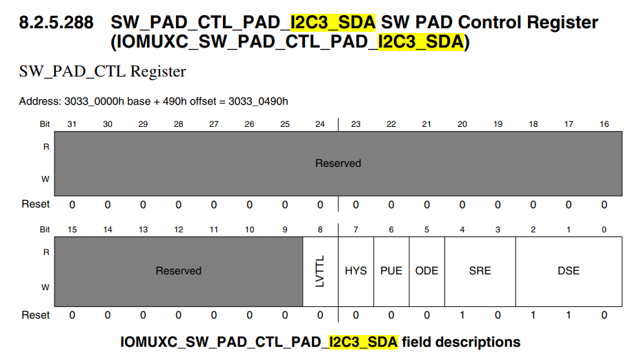

What do the hexadecimal values correspond to?
On screen, it's just an example of a pin whose mode I would like to choose.

You can have a reference for GPIOs with the IMX6 definitive GPIO guide.
But as pointed out by you, the value is for SW_CTL_PAD or pad settings,

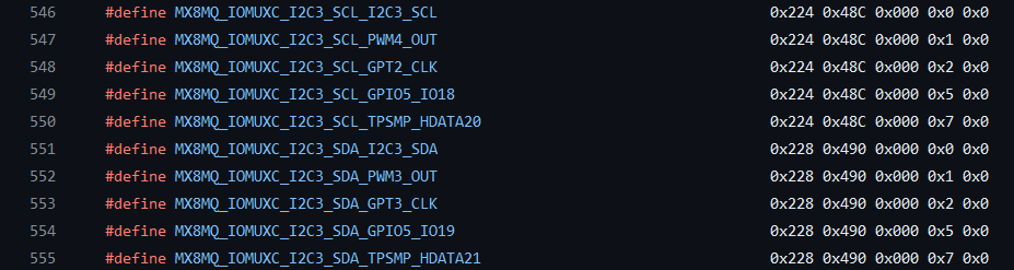

The SW_MUX or the muxing is in DTS and the string at the beginning, extracted from linux-imx/arch/arm64/boot/dts/freescale/imx8mq-pinfunc.h defines the MUX.
