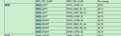

Hi, are there any examples for using MQS with the RT1176? I have found an example on the forums for the RT106S which has provided a basis to work from, alongside the SAI DMA audio examples for the RT1170 EVK. However, integrating the MQS is proving difficult and the documentation is quite unclear on exactly how things need to be configured.

Thank you very much for your help. I understand the need to use the SAI3 module but have been having issues getting it working. I think some of the code in the sample file you have provided above are related to the RT1060 SDK as I am having errors when building it. I'll see if I can work them out.
Could you please confirm as well that only the MQS pins need to be configured as outputs? In our design we are using the SAI pins for other functions but in all of the audio examples I've seen the SAI pins are always configured as outputs.

   If you choose the pin as the MQS pin, it is the output.
  You just need to configure the related to pin as the MQS function.
to the SAI function, you also can configure it to the RX, not only TX.
Maybe you mean the SAI data pin RX and TX share it together, to this situation, you don't need worry about it, if you configure the pin as the RX, then it will be input.
About the RT1170 MQS demo, you can try to migrate it based on the RT1170 SDK SAI demo, if you meet any issues about, just kindly let me know, as it is not difficult.
