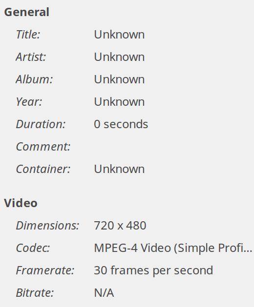

Please correct me if I am wrong: the mp4 file that I create either with gst-launch command above or the C example code from libimxvpuapi is only the encoded stream without a container. The video stream needs a container in order to be played (by VLC or other players). I can see the file is missing a container:
This ffmpeg command creates an MPEG-4 container for the video stream:
ffmpeg -i video.mp4 -vcodec copy output.mp4
The gst-launch command that I had above needs to be extended with an mp4mux in order to create the container. The output file then works.
Would have been nice to have a function in libimxvpuapi to create a container for the encoded stream.
Please let me know if I'm wrong about this container thing.
