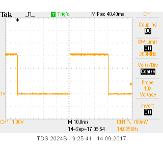

What do you mean when you mentioned that “all output voltages except 5V from SWBST are resetting every 30ms”?
All outputs look like on this picture:
But SWBST output is OK:

 Yes. In high level they match to values shown in Table 10.
