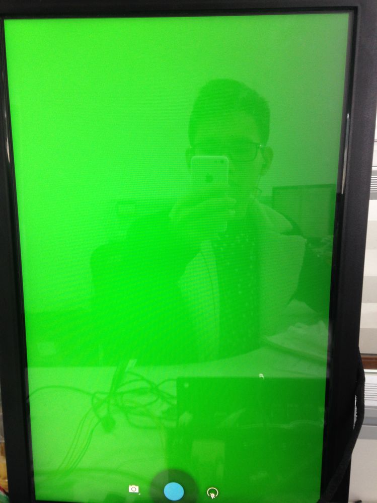

佳杰吴
Hi, i put the uvcMJPG.patch,but it cann't preview ,it shows that IMG_2282.JPG
Platform:
android4.4.2
imx6d
do you have any thoughts or advise about this issue
