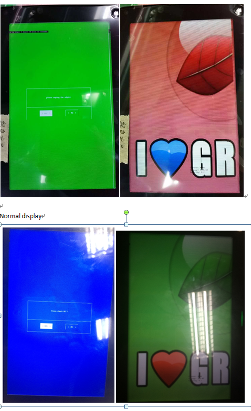

I have a MIPI display color error issue, its fail rate is about 1-2% when power up,
please refer below picture,
when we reset the MiPi core by memdbg. display will become normal,
MIPI_DSI_PWR_UP register,
memdbg u32 0x021E0004 =00000000@@
memdbg u32 0x021E0004 = 00000001
could you give me some advise to fix this issue or some thing we could try to add in the MIPI driver?
abnormal display color change to Green or Red

it may be recommended to check power supply VDDHIGH_IN, VDDHIGH_CAP, it powers
MIPI block NVCC_MIPI, and move it first, if possible, along with
VDDSNVS in power-up sequence. In general extending POR also may help.
igor

igorpadykov
Hi Max
1  check power supply VDDHIGH_IN, VDDHIGH_CAP voltage ripples
2. extend POR up to 1 sec.
3 change power-up sequence so VDDHIGH was 1 step with VSNVS
igor
